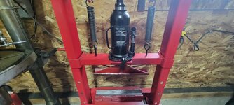

A good friend of mine had a nice press and several other engine rebuild tools moved after he retired.
To fill the void for things that are larger than my arbor press can handle I picked up a POS HF 20 ton press.
The plate/cross member that the bottle jack sets on is atrocious. The rest seems OK.
Rainy day here at the cabin so I drew up a new cross member.
The tubes are 1.25 OD DOM with 1.030" ID. A 1" diameter rod of UHMW will set in them and the cap will be tapped with a 3/8"-16 threads. A bolt and jamb nut will be adjusted to push the rod forward and locked to take up all play. The jack plate is sized for the HF air over hydraulic bottle jack.
The center press rod is 1.5" 4140 5" long. 1/2" diameter counterbore and size tapped 1/4-20" set screw so interchangeable noses can be used. A tab is tack welded to the rod and retained to the cross member with two 3/8" bolts so it can be replaced if need be, but it pushes directly against the jack plate.
Every thing is laser cut 1/4" steel with tab and slot welds to assemble.

Decided last night before falling asleep that the UHMW tubes don't need to be 1.5" long, adjusted them to 7/8"
Also shortened the ram end. Since it wont ever push directly on the part in this configuration, i can make longer or even different length ends to suite.
Does anyone have the return spring spacing on the newer gray HF 20 ton press? I forgot to take that measurement before I left on vacation and I sort of want to get the cut files to sendcutsend as soon as I can.

No help as I only have a 12t, but nice design. I like the setup for taking the slack with the UHMW.
-No info, sorry but asking what CAD program you're using? Looks like SolidWorks, that's what I have here at home. My 12T press from Horrible Freight has been waiting for me to make similar upgrades so it's not a "variable position" press.
I wonder how similar in dimensions the 12 ton is? If you take some pictures of the 12 ton jack cross member and vertical C channel with a tape measure in the pic I can see? There is a possibility that just a different top/bottom plate could be used with the existing side plates and end plates?

Might as well build a whole press!
I thought considered it, but this is still much cheaper than a whole press as I couldn't buy the C Channel for what HF sold the whole press for.
The parts are precision cut and are self jigging. Drilling all the holes for the table pins in the length of channel accurately didn't appeal to me.

What do some of you think about this plate that is bent in a vise and welded on the seam? One would cut off the original ends of the jack crossmember and weld it on.

This is cool. I don't know how I'm just seeing this thread. I have the press you are working with so I can take some measurements if you still need anything.
My problem with just replacing the ends on the original part is that the pressing shaft on mine is welded and cut so crooked that it is basically impossible to use it for pressing on anything straight. I've contemplated taking it to my machine shop and having him machine it parallel with the plate the jack sits on, but it would still be a POS part :lol:
I would be VERY interested in buying a copy of your final file that you send to SendCutSend if you were ever interested in sharing your design. This looks like an great upgrade for these presses.

20 ton press jack base v4.1.jpg20 ton press jack base v4.2.jpg20 ton press jack base v4.3.jpg20 ton press jack base v4.4.jpg
The jack is not the correct model but it gives an idea. The C channel is simplified (no taper to the interior) but the outside dimensions are correct. Pictures 3 and 4 show the 0.25 gap to the C Channel. I am not going to insert the UHMW rods in the model but they would be in the cups and are adjusted to take up the gap without binding. the 0.25" on each side leaves a full 0.50" total adjustment possible.

I too would to see it laid out. Your model doesn't show the '1" diameter rod of UHMW' for the adjustments which might be confusing to some. I like the design (I have this press) but question why there are two sets of tubes for adjustments on each side above the cross member rather than one set like below it.
The more area there is and the further apart they are on the inside of the rails the more resistant to cocking it will be.
I put only one below the crossmember as if there was more it could run into issues hitting items to be pressed or attachments such as the SWAG off road finger brake.
Above the cross member there is more room as the jack cylinder completely collapsed leaves plenty of room for a second one. Even more could be added but its probably past a point of diminishing returns.

I did something mechanically very similar to yours.... But mine is not nearly as pretty as yours :D....
I used 1/4 in. UHMW flat stock at the wear points..... A big improvement in the press....

First thought before the coffee kicks in.....nice modeling, knew you could do it. Thought the UHMW rollers would be on the inside of the vertical rails. I'm not awake enough for analysis, more later....

They aren't rollers. Those are tubes he would weld on & thread the end cap so that when he cuts ~1" lengths of 1" diameter UHMW rods they will sit inside the tubes and be pushed out with an adjustment bolt.
Wouldn't some type of roller be better though? Wouldn't the UHMW wear the paint/powder coat away with up/down movement?
I would think it would take a LONG time for UHMW to wear away the powder coating. You just tighten it up enough to either barely touch or leave a slight amount of movement.
Sure a roller would be "better" but overkill as well. I just shoved some pieces of cut 1/8" cutting board in mine and glued it on. Most of them have fell off by now but I don't use the press enough that it bothers me. If I was getting pieces laser cut with the intent of using the press to make production parts or such then I could see wanting to make the cross bar better.
Thanks for the info on UHMW. I don't use my press a whole lot either but I do notice the cross bar flex when I do.
