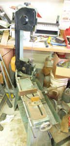

I fixed my problem.
I found this on craigslist; (pics at end of post)
when I went to look at it i brought some scraps to do some test cuts
this thing cuts like a champ. the only thing is that it's supposed to have a coolant system and all that was missing, as was the hydraulic feed... this one was designed to use the spring
looks like the dayton is now actually a wilton :confused:
i returned my horror freight saw and since it was over $100 they will mail me a check.
I got a saw that cuts like a champ for $100 less than the HF one. yea I'm a happy camper
