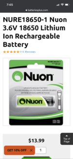

Don’t know how good they are but I got this one for my headlight form Batteries Plus.
those are the ones that were eighteen dollars and change when is was shopping a few weeks ago. I just checked the local Batteries Plus for the high capacity 3400 mAh and they are down to $15.50 - and they don't state that they are protected.
I will keep shopping.
