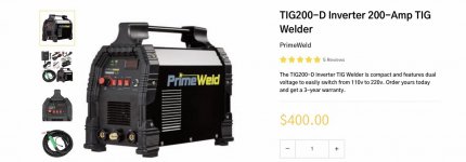

+1, my stick welding looks waaaaay better than flux core.
OP, consider this welder for $400:
https://primeweld.com/products/tig200-dc-inverter-tig-welder
I like the fact that it comes with the Tig torch. A lot of companies make you buy it separately.
