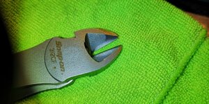

I don't have a pair of the Snap-ons but that appears to be a bi-metal insert. Could it be something like cobalt?
K
kapster
Dec 14, 2011
517
Wooster, Ohio
I think the discoloration is from induction hardening the edge, per their description.
