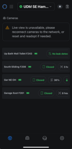

One option (but it’s battery powered) that’s versatile is from Ubiquiti. It’s a multipurpose sensor (but if configured for water sensing it looses other capabilities). Unfortunately the water sensor is only available as one of the three sensors in a 3-pack. The advantage is that you can check multiple types of sensors from one app. I use them mostly for monitoring door open/close status and it simultaneously provides temp, humidity, light, and motion sensing. You can also add cameras to the system.
Here’s the dashboard with 4 sensors and no cameras.
