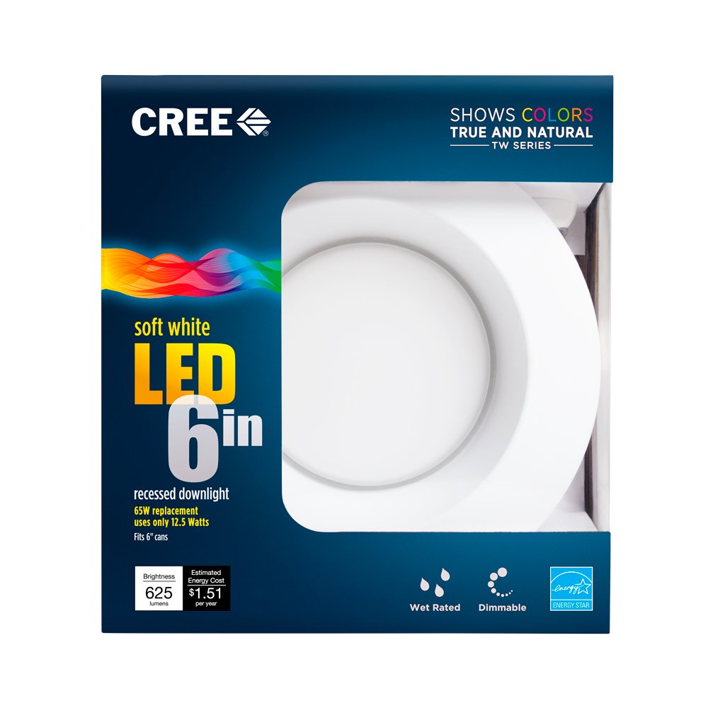

For fixed lights, you can probably rig these cans into something portable. They're high CRI, so the colors are closer to incandescent and don't look faded.
I have these in my bathroom and the light color matches my soft white incandescents over the vanity perfectly.
