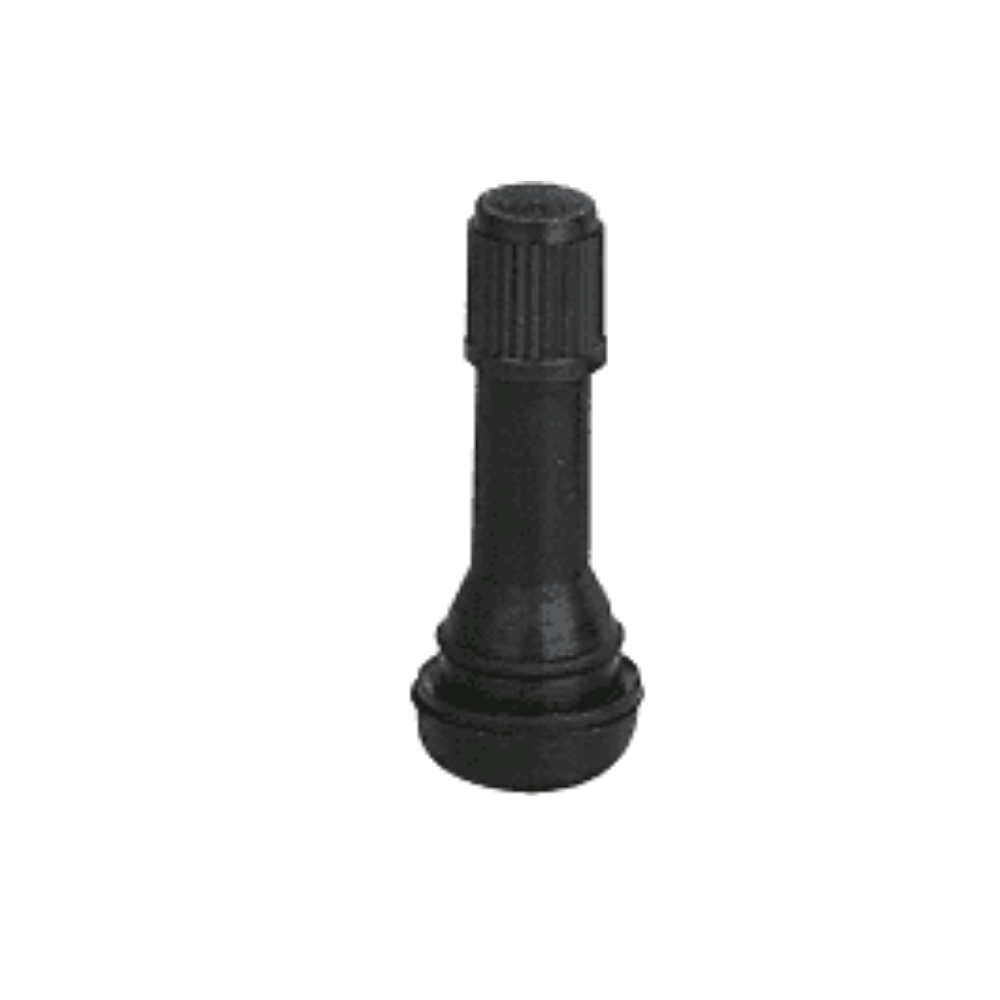

I did techtirerepairs in the TR600 flavor so I can also install these on the cars if necessary even if it's overkill (would rather that than rot hopefully)....perfect for the MK4 ALH TDIs as I tend to run higher pressures anyways for fuel economy.
Crossing fingers!
Thanks for all of this.
