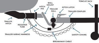

In times of haste, we sometimes forget the very basic of disconnects. With safety chains and trailer wiring already removed, carefully adjust trailer height with tongue jack to remove weight/tension on hitch/ball assembly, chock wheel(s) on trailer to prevent movement, pull safety clip, pull hitch pin from hitch, pull tow vehicle forwards. Truck and trailer will now be detached from one another as the hitch is pulled out of the frame assembly attached to the truck. At that point, you can lift lock tab on hitch above ball assembly, and with no tension, the two items should be easy to disconnect from one another. If not, then a BFH may be required to give the hitch itself.
Now, with that said, with your history of using mostly pintle hook hitch assemblies, did you remember to raise the hitch latch when you were trying to remove the two assemblies from one another? Nothing to be embarrassed about, I've seen plenty who have been in the same situation at the track over the years.

The OP's rant seems to be a bit confusing. After reading it a few times I get the impression that the ball is stuck in the trailer coupler because the latch assembly won't release. I have had the same experience, usually because the trailer has been sitting awhile and the pawl hidden inside the coupler is rusted in place or jammed at it's pivot point towards the rear of the trailer. The pawl has a "C" shape at the rear that loosely pivots about a rod going side to side within the coupler. Usually raising the latch handle straight up and pushing it straight down (sometimes with hammer assist) will push the pawl down and away from under the ball. Plan B is hitting the pawl from below.
Bill S.
Nice post, but the actual hitch latch mechanism that came with the new trailer didn't come loose - despite many many attempts to pull it backwards - until it was off of the truck/trailer and in our fab shop.
By the way, we have other equipment, including a couple of smaller enclosed trailers, that employ a latch like the one in the nice drawing (above). The hitch latch that came on the new equipment trailer I originally asked about, on the other hand, doesn't look like the one in the drawing. It's much smaller/cheaper and it doesn't have the cam action that most of us are familiar with. If I get a chance, I'll take a high-res photo of the Chinese junk I've been writing about so everyone can see what "cost savings" often means to the customer.
