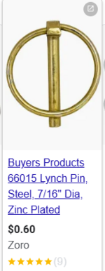

I've never liked the detent pins. Once it gets gummed up, the ball either doesn't pop back out so the pin falls out, or it gets hard to force the pin through the hole. I like lynch pins as long as there's enough spring in the loop to keep it in place. Depending on the application, the pin with the wire that wraps around to the other side can be ok, but I don't know if I would use one here since the wire can catch on stuff and pull free, then there's nothing keeping the pin in place.

I just went through similar on the quick release bucket on my mini excavator. It has about a 1.125"x6" pin. There is no load that tends to slide it out of place and I got tired of always needing 2 wrenches for the bolt and nylock that came w/ it. I found a pin like the first one in post #13 but the ring was pretty large. SIL borrowed the excavator for a week and went through 3 versions. The ring kept getting caught and popped loose on brush etc. He found one that the ring is just 1/4" over the diameter of the main pin so it stays in place. If you can find that style in the right size they are great. Having that nice ring to pull the pin out with makes things easy.
