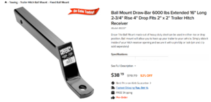

Would one of these work? They are available in different heights.
I am looking at some variations of those. Found one that might work. It would give me some drop so that I could perhaps get away with a 6” drop drawbar. That would also allow me to remove the drawbar and not whack me knee on it.IMG_3337.jpeg
is that better than one with now drop and less drop in the drawbar?
Not sure what you mean? The one in the picture would be flipped so that the receiver is on the bottom. It’s a 4 inch drop, so I would need a regular 4” drop drawbar to get a total of 8”. The top tube is 2” just like mine now, so I should be able to cut the bracket off and weld it on. And I could remove the drawbar when I’m not pulling a trailer. It’s really back to my original idea.
There are similar ones that have less drop but you'd need a 6" drop drawbar. Or others that have a 6" drop that could use a regular 2" drop drawbar.

Yes. It’s a function off finding ones that are long enough and have enough of 2” tube on top to swap the bracket to. Or I just add a receiver to my existing drawbar like my original concept. 6 of one , half a dozen of another.
