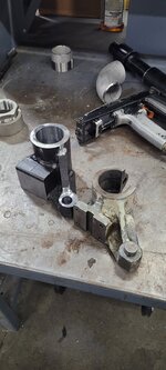

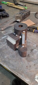

We have this old hobbing machine that is orphaned. I think it's from the 60s. We had a part go bad it cracked in a bad spot near a gusset. The stock bar is so far out for this I decided to make a weldment. I made two weldments and let them mellow. Then I machined some reference features and mates them. Did the final weldment today. It's mellowing out in the enclave now for rough machining tomorrow. Once more in the oven then final machining.

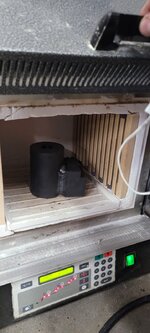

Pretty cool, more about the process and material please. Why the cool down in the oven? Did you preheat as well?

I assume he normalized it. Which is just getting rid of stresses present from all the welding he had to do. So the part doesn't move all over the place as he machines it out.

Exactly.
So we didn't wanna braze it because the piece flexes to clamp and there's a gusset right where it broke so we thought it would be a bad repair.
I machined out the part that's going to clamp, welded it on and it's in the oven tonight for the last phase. I got a haimer today which is going to aid in finishing it. I found the center of the bore and installed a hardened pin so I can transfer the center of the bore to the perpendicular plane for the slot I have to put in.

I think its all 1018. I took it off the Misc materials rack. Before I came on board things weren't not nicely labeled. I made a program to make adapters and the material I found I could go crazy. Cut like 12L. Found some more and put it in. Tool steel. My end mill did not survive the first pass lol
