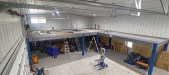

I was wondering if anyone knew where I could buy 3" x 3" (or smaller opening) welded wire fence panels at a reasonable price?
The safety rails that came with my used mezzanine met OSHA standards (basic 42" rail with a single crossbar and top bar), but my local inspector has told me he will require me to meet domestic construction code, which requires that a 4" sphere cannot penetrate the rail anywhere.
I bought a bunch of 4" hogwire panels on Craig's list (it's also available at Tractor supply at a very reasonable price), but having done the 'ball' test it seems very close - there's a few places where the wire is slightly bent where the ball goes through with the slightest push. To be fair, I do have a slightly squishy rubber ball, I've just ordered a rigid wooden ball to test with that.
In theory 4" hogwire should be ok (because the 'holes' are 4" minus the thickness of the wire - about 1/4", but I think the manufacturing tolerance isn't that tight. I'd hate to have it fail inspection once installed - so I'm looking to see if I can find something that meets the standard without breaking the budget.
I'm considering buying panels with a smaller mesh (ideally 3' x 8', but 4'x8' works), but can't find them anywhere at a reasonable price (tractor supply works out at $50 per panel for the 4"x4"). I do want rigid panels (not rolled mesh) as I want to make 'infill' panels with a welded U-edging strip.
Thanks in advance for any suggestions!

Thanks to everyone who's got suggestions - really appreciate it.
As background, I'm trying to get a look similar to this, but for a fraction of the price.
I need to make around 14 panels (for the safety rails, and also the stair rails), and I've already bought the steel U-edging, so I'm pretty much committed to this approach. I'll admit there's a lot easier ways to do it, but I'm a little obsessed with the asthetics :)
I've posted photos elsewhere on the forums, but if you've not seen those here's the mezzanine under construction (with no guardrails...yet)
