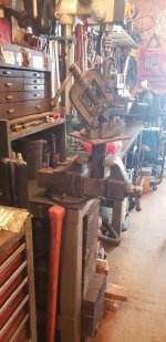

A friend calls up and needs several pieces of 1.5" conduit threaded. While I have pipe vises, I never have them bolted to the work bench since I use them infrequently.
So with some scrap 5" channel, I made some bases for the two pipe vises so they could be clamped in a 5" bench vise when needed. I added the two strips of grey painted steel to self-align the pipe vise to the top jaws of the bench vise. Without them it is awkward to clamp the pipe vise without it being at an angle.
I decided to clamp on the C channel cross section and not the side flats. I was worried that if I clamped on the C channel side flats, the C channel would bent and thus put stress on the pipe vise castings. Clamping on the cross section should prevent this from occurring.
Picture of the chain vise and adapter plate shown below

I made this base to hold my pipe vise in a bench. Nothing fancy, just 1/4" plate welded to 2" round stock. I did it this way so the pipe vise can be rotated anyway I want since none of my bench vises swivel.

Nice job and I think you made a good choice clamping it as you did, I would say another possible alternative is to weld a heavy flat bar in the center of the flat plate to make a "T" cross-section, then you could clamp the single leg and not worry about the bending of the flanges in the C-channel.

^^^this^^^
Most vise-mounted tools (rollers, benders, beaders, etc ) are set up this way; you don't have to extend the vise jaws out so far, minimizes movable jaw deflection and you can clamp it more securely.

PLUS I’m pretty certain you would be putting less stress on the bench vise itself.
