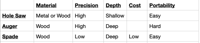

Here's a table I came up with to help me visualize what I think is correct:
Any other attributes to add? Maybe diameter? I'd guess auger bits will be most limited in diameter compared to the other two?

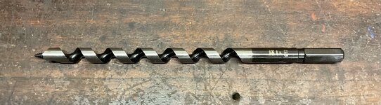

You’re right about Auger bits, generally the best option, and can be had in many lengths. Again, get decent ones. Long auger bits are expensive and easily damaged so always get some shorter bits.IMG_0169.jpeg

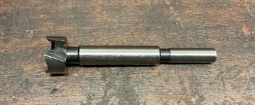

Forstner bits have been mentioned, and these often are the better option. They give a superbly clean hole. and are have an almost unique quality, in that you can drill overlapping holes with them. Highly recommended.

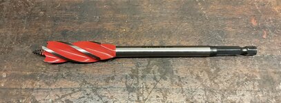

Finally, consider the “fast” auger bits that are popular today. I don’t always like these (some make very rough holes) but the decent ones definitely have their uses. There are special short shank versions for drilling rafters.
