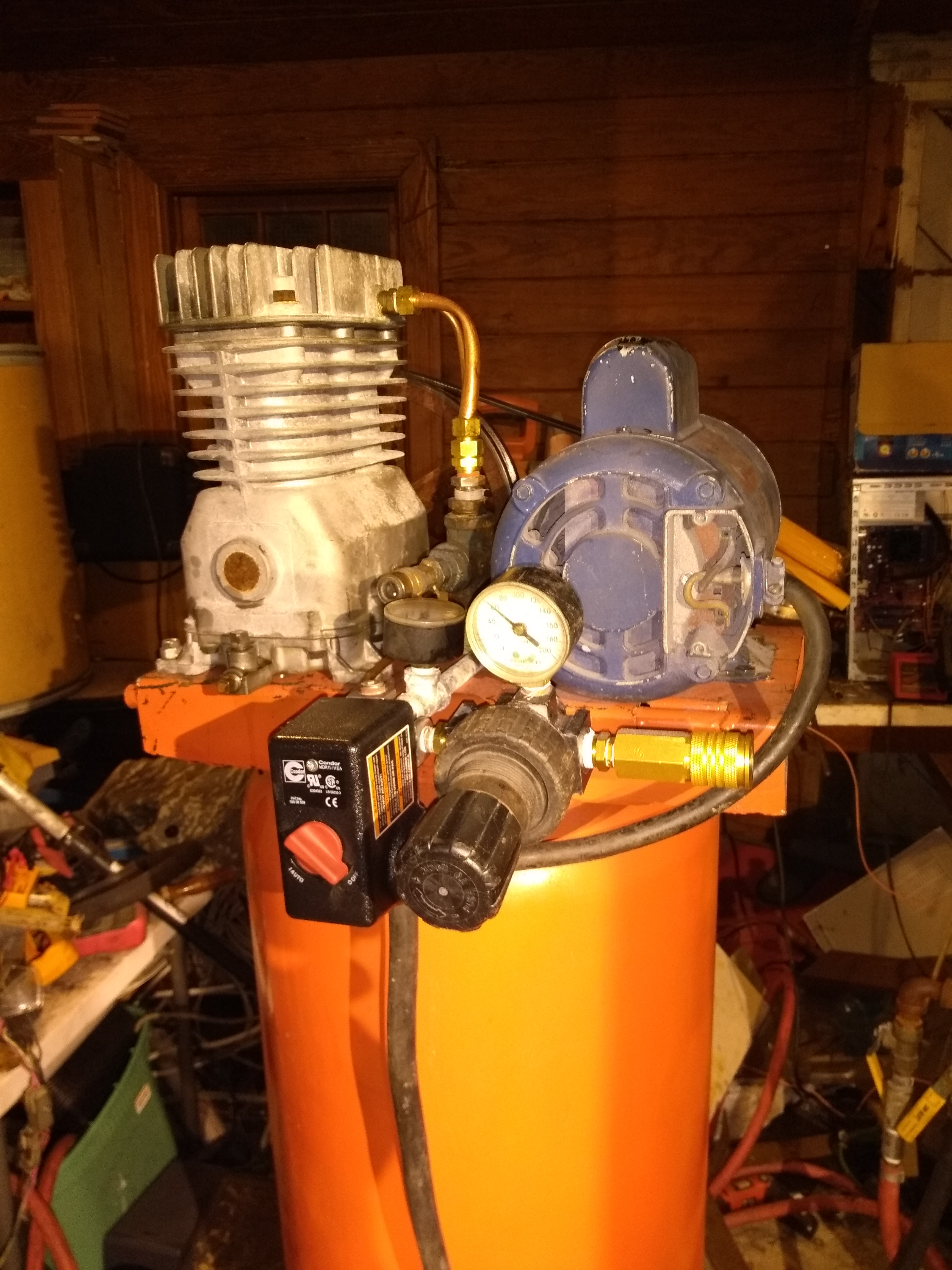

Here is a picture of the current configuration. I'm presently redesigning it using a different pump. Results of the latest revision will be ready this afternoon.

output looks way undersized tapping off like that, if you disconnect everything plumbing-wise from the pump, does anything come out of it when it is running? I can't see from the pic where the unloader line is either, regardless, if it spins, air should come out.
is the reed plate installed in the correct orientation?
here is a similar pump schematic I have, maybe the plate is backwards, upside down, the reeds missing the hold down's, or just plain broken rings...

Yes, it has output. It pumps up to 100 psig before it starts squalling and bogging down. The unloader is behind the output line. It's a 1/4" line that connects to the pressure switch.

That kink in the discharge line isn't doing anyone much good, but I doubt that's causing your problem. Also, it looks like the belt may not be engaged completely. The sides of the belt need to be in full contact with the sheave. It could be the wrong size or loose, but it's not easy to tell from the photo.

I would assume the problem is belt slip vs the load on the pump is too high. The pump and motor are very close together. You might not have enough belt wrap around the pulley. The motor sheave might also be too small for the hp load. It's also possible you have a flow restriction so the pump sees pressure that's much higher than the tank pressure.
Speaking of pump outlet your pipe looks kinked. I would suggest a longer run with a loop in it. It reduces cyclic stress on the tube and would reduce the restriction in that bend.

It looks like you have a Load Genie on the line. You can't use that and a pressure switch unloader and a check valve all at the same time. I would need to see how your blowoff/unloader line is plumbed in, and where. Just a theory at the moment. The pump is pumping ok, the air is getting to the tank, so it sounds like a control issue to me. Unless the motor is severely overgeared. Is it a 3450 rpm? You should limit a single stage pump like yours to about 120psi max.

could be your check valve stuck open or not working. if you disconnect the line so you have the tank pressurized through the line to the check valve, but with the pump disconnected, does it leak? work backwards from the tank once it's pressurized and starts to slip. shut it off. be careful the line will be HOT.

It appears that the copper tubing coming out of the pump head is kinked and undersized considering the sharp bend. At over 100 PSI the air is flowing less then 20 to 25 percent of the time. Therefore the peak flow rate is very high which causes significantly more motor load.

Thanks for all of your help, but I saw a 5hp Campbell Hausfelt listed for $75 so I snapped it up
On the original one that we started this thread about... I put a smaller pump on it and converted the belt over to a "V" belt instead of the ribbed and it ran really well for about a week, but then the pump failed and I gave up. I'm now using the tank an auxiliary to the new one because the CH only has a 20 gallon. Thanks again, Jim
