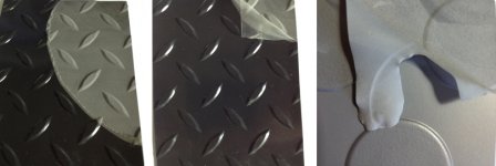

Thanks - interesting your feedback. I got the Diamond Deck flooring samples this afternoon. I noticed two things (apart from it being nice and soft, and good looking).
a) The colour is consistent throughout.
b) There is a cover layer over the top bonded to the "underlayer". I scraped it off with my finger nail (a portion of it anyway) and I was wondering what you thought of it in terms of longevity of product. I dont want it delaminating in the middle of winter or summer. My garage is outside, and will be exposed to -40degC in the winter and equally, + 35degC in the summer at times.
Any thoughts there?
Tx, G
Any thoughts there?
Tx, G
Thats funny. I did the same thing!
I guess items (a) and (b) are mutually exclusive to me. All of their products appear to have a gray base layer with a thin layer of color at the top. I just don't know the answer to the question. YES, we can peel it off with our nail, but how does that relate to real life. For now, I am sticking with BLT. Its not perfect, no product is. BUT its made in the USA and except for silver is the same color on the top, in the middle and underneath.
