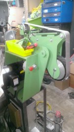

ALL: one of my local guys built this one with a kit from one of the teachers at a local community college and I liked it. i think he's using a 5 HP Baldor, but he does heavy steel grinding and I think he loves Tim Allen. if I recall he has 20 different grit belts hanging at the ready.

Bigblue&Goldie
Mar 12, 2009
10,684
Mine is a Baldor TEFC. I spent the coin and I'm glad I did. So far in testing it's super well balanced.
