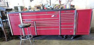

Hi everyone,
I've been reading the forums here for a good year or more whenever I am looking for a little inspiration and finally decided to register an account a few weeks back, so hello all.
I find myself with a lot of downtime in the shop during the spring/summer months and often starting fiddling with stuff just for the sake of fiddling with it, and this started early this year with a end cab build.
My work box is a Snap On master triple bank which is mostly full (and top drawer almost unusable from so many guns/etc laying on top). I have a side storage cab however it houses all of my scan tools so I needed another cab to house my impact guns (5), flashlight, grinders, hammer, etc. The existing side cab already has a mod to it with an articulating laptop arm, wired into the scan tool storage area as well.
So I was in need of another side cab to house my air and electric tools, quite honestly don't feel like laying out another $2k+ for another cabinet, and I have an abundance of everyones favorite material, old bed frames! Stay with me here.
I cut the frames up, cope the corners and framed up a box.
As we know bed frames are pretty junky and warp really easily. So I mocked it up on the box to make sure things were still square.... about 1/4" off in two spots, I'll live with it.
Inside the box I used some old industrial shelving leftovers to build the actual weight bearing portion of the box. This is welded to the inside of the outer cosmetic structure and is not only the portion that is bolted to the roll cab, but also the portion that the shelves will mount to inside (more trustworthy to weld and easier to drill than the bed frame of course). I tacked in a spacer in the front opening area to gain the correct width, then took the door off the existing side cab to mock it up on the new box to make sure the opening is still square (it is, door is just laying in place).

With the inner structure complete the remaining braces are in place and uprights for drawers added (more leftover industrial shelving pieces). At this point some protection was in order so it was quickly sprayed with some leftover red paint ('14 Mustang, if anyone cares :p)
Now was time for some sheeting. Originally I was going to use some old file cabinet sheeting, however most of that stuff is around 22-24ga and pretty flimsy. The Snap On material is supposedly 16ga, though honestly it is more like 18ga with some thick paint, it doesn't quite hit 16ga upon measurement. Additionally, of course I am not using this for structural purpose like Snap On does since I don't have a super expensive machine for doing 180 bends etc, so the sheeting is not terribly critical by comparison anyway. With the cabinet sheeting simply not cutting it, I called in a favor and had a buddy in Orlando pick up some 18ga sheets for me and traded them for a blown 6spd ******. Good deal, there are literally zero steel suppliers near me.
So with fresh sheet in hand I went about the only bend on the box, rounding over from the top to the face. The old fashioned way it was... clamped and twisted, and when that gave up the mallet stepped in. Worked well. Sheets when on with 3M PanelBond. That stuff is for real.
The remaining trim on the front was installed and side sheets were added, extending 3/4" past the front of the box for trim mounting.
Holes drilled for the door and rechecked fitment... OK. So corners are smoothed in and some primer is introduced while the box sits waiting for some paint and shows off some parts from Snap On.

Getting the magnet situation in order took some time and thought. The Snap On cabinet uses a 4x folded thin sheet of metal with magnets snapped in. I got the magnets, but the folded sheet you can't buy. ******.
So I ended up taking some 3/4" square tube and section a 90 degree quadrant out of it. Then in the open area I used that access to cut slots for the magnet. The tube was then cozied up around the inner corner of the door upright. Looks like it will work alright.
Still waiting for paint.... so boredom sets in again. We've been using a decades old inoperative welder as a welder cart... its so heavy it takes two people to move and even then barely rolls (no bearings in the rear wheels just plastic discs over a rod). So scrap to the rescue! Note I have since added braces for the welder so a bungee is not necessary :)

And still waiting for time to get painted!
So more time killing... some rag storage perhaps.
And finally I get to throw some paint!
Thingamajig added to the right.
And magnets installed... worked great!
Last round of pictures coming...

Finally, time to see some return on investment! Mounted up to the old box... not too bad. I still was off about 1/4" from the bed frame warping initially but its totally passable. I had split the difference in the pictures but ended up compensating 100% for front facing being accurate so the trims are dead flush on the front. The top rear is down 1/4" almost in one corner, but since I can not use a Snap On work surface (due to difference in how they are constructed from mine), I plan to build upward with some shelves or something else amusing anyway. In case anyone is wondering/didn't notice, the factory mounting holes are used for hanging the box, and lower pinches are bolted through as well, just like a Snap On cab, just without the ultra-helpful 180 bend on the top to hold it while you bolt it up :(
I created provisions for the factory pull handle, however the rag storage won out on that battle. Also note previously mentioned thingamajig has been installed... My extra long prybar (PryZilla!) is a royal pain to put away in my tool box so I always leave it laying around... and it always falls over etc. So I just took some old galvanized pipe, cut it down and cleaned it and welded a tab on it to hook to the rag basket so I have somewhere to put it where it doesn't fall over. The tab just has felt inside it so I can move it around the basket if needed.
Please pardon the massive mess on the tool box, I've been busy not cleaning :)
I hope that was at least mildly interesting or amusing, it was quite a bit of fun to build. I know it is not super accurate, but the goal was to work with basically $0 budget... then the more I got into it I decided on spending the money on the proper door and trims, but beyond that is was all barter or salvage material, so not too bad given what it came from! I still have to construct the drawers, but have yet to come up with a gameplan on that yet... unfortunately I am out of reason to put it off, so it's time to get to it. I haven't been able to find any real useful custom drawer builds to take inspiration from, so I'll probably just end up winging it and hoping for the best!

I started on one drawer today. Since being square is pretty critical for the drawer, no bed frames this time :)
I used 3/4" angle to box in the frame, then two pieces of the angle in drop position across the center. It was super windy today, so I probably did more grinding than welding, it was ugly weld day for sure.
Test fitted to the drawer slides with some wood screws (bolts later), and everything fits nicely.
The bottom of the drawer is lined with one of my last pieces of 18ga. I have literally enough to do two drawer bottoms and that is about it excluding miscellaneous scrap. Luckily I do have a good amount of 20ga for sides etc.
Drawer bottom will be PanelBond'd in over night tonight.
The plan tomorrow/next week will be to reproduce the above for the second drawer bottom, and then on the top drawer begin building upward with it. The original plan was to have uprights on the right side of the drawer and have a shelf of "holes" going back that the impacts can all "holster" into. The bottom tray of the drawer could then hold air grinders, etc. However looking at it currently, I may have made the top drawer too high for that. While it isn't terribly difficult to lower the slides, it isn't terribly easy either (since I can't reach through the side anymore)... so whether I will deal with what I have or move the drawer down some remains to be seen. Odds are I will have the weekend to think it over, perhaps draw up some plans if I remember to write down measurements before leaving tomorrow.

I did begin building upward with the top drawer. I used some 1/2" square tube to build a wall up and a platform to hang the guns from. It needs to be narrowed in the "rear" still and I will likely put a 3/16"x1.5" piece of scrap bar I have across the "front" section where they hang at a 45 degree angle. Then both contact surfaces will be felt covered. That is the plan anyway. I was going to put a diagonal brace on there too, but the thing is so strong its really not necessary, it would be just for show. The back of the upright will get either some 20ga sheeting or maybe some grill bars from the remnants of the shopping cart. The rest of the drawer design is still mostly undecided until I get the actual primary function portion finished.
Meanwhile I did learn that the drawer slides I got are ****. They flex so much, just leaning on them slightly when the drawer is extended you can see then flex downward a ridiculous amount. 100lbs per slide my ****. Its totally sufficient for what it is holding, but it irritates me so I will likely see if Snappy has some take-offs I can score. I like being able to stand on my drawers. Not because I need to, I just like knowing a I can.:lol:

I've been busy at work and haven't had much time to work on this unfortunately, but I did get one drawer mostly done.
I added a spacer bar where the rear of the guns rest to balance them out, as well as spacers in between to keep them from flopping around etc. I had to do one a little wider than the rest for the Snap On 1/2" air impact since its a fatty... and wouldn't you figure that tiny little bit extra made the one on the end just a tad narrow for the 3/8 air impact. It fits still, but not the same way the others do.
Not pictured, but I also added a 2" high rail (more old 1/2" box) around the perimeter to give the impression of a typical drawer, and I tacked on a 20ga backing on the "wall" part. The ends of the box tubing I leaded solid and will probably do some spackling on it tomorrow or Monday and ready it for paint.
The bottom drawer is still basically flat... any ideas on what to do with it? It will have about 6-7" in clearance roughly.

Got some quick and rather dirty paint on the drawers and started trimming them up. Used some aluminum hole punched scrap I have a few sheets of to trim the back wall of the gun rack. Up top the resting area for the triggers has 3mm felt across it now. Pics are kind of dark unfortunately.
Should have drawer liners arriving tomorrow as well as some stainless hardware for final drawer slide assembly!

This should be the final update, unless I decide to try to mimic the top surface.
Drawers are fully assembled and in use; aluminum punch out is on top and bottom of the gun rack, felt padding on the resting surface, and rubber drawer liners cut to fit. Also figured out the air hammer fits fine in that last slim holster, so I swapped it with the 3/8 impact :beer:
