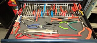

After looking at about two dozen different wrench organizers, I realized I didn’t like any of them, so I made my own. These are made from 1/4” aluminum. I used 2” wide and 1” wide pieces. Measured the thickness of each wrench, added .010 for clearance and milled slots an 1/8” deep and pressed the 1” wide pieces into the 2”. Then added labels. I also added two strong magnets under each holder so they can’t slide in the drawer. I have two smaller drawers to do yet, but these are the mainly used ones. ABCC74DF-052C-4651-9956-F075C60BE3B1.jpeg

I've made them out of aluminum rod, coil it around a bigger rod into a spring shape. Then adjust the width to accommodate wrenches or pliers etc.
Also have used wire shelving. Oddly enough this has been the best setup i've come accross and I've gone thru alot lol

The only issue I had was really watching the sizes on the 1” pieces as the thickness varied from stick to stick from .242 to as much as .254. I measured each new piece and took that into account when milling the slots.
