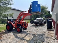

Four weeks ago, I picked up 60 bags of 30lb mulch, a minimum of 1.650lbs. My tractor would lift it off the deck of the trailer but not high enough to clear the fender. I didn't really need it off the trailer, so I didn't mess with side shifting it around the fender or taking the fender off. It did make me look more at something I had read about, with increasing the pump pressure. I ordered a kit that came with a nice pressure gauge and 4 different sized shims for the bypass valve.
Last night when I got home, I hooked up the gauge. Kubota spec for my tractor calls out 16.2MPa which is 2350 psi. My tractor read 2365 psi at 2700 rpm.
The mod was as simple as removing the pressure relief valve and, in my case, placing a .004 Kubota shim under the spring. For every .001 shim it bumps the pressure .027 MPa, this took the pressure to 2525 psi a 6.76% increase. I decided to go conservative for now, I can always bump it some more later. I did not do all the math for 2 lifts cylinders ** diameter vs pressure to figure out how much more weight it could lift. What I did do is take it out and lift something.
This picture is from a couple years ago, when I first tested just how much I could lift with it. The barrels are 55 gallon and full of aircraft exterior soap, according to the shipping information they are 525lbs each plus the weight of the pallet. My tractor at max RPM would lift them just over the height of the hood.
Today I tried lifting the same load, it's on a smaller pallet but its built sturdier and probably weighs very close to the one in the picture above. The first thing I noticed was the tractor could lift the load at an idle a few feet off the ground. At max rpm it lifted the load to its max height. I didn't play around with adding any more weight, I have enough time on the tractor to know it was very close to its max lifting capability, it may have handled another 30-40 lbs. at the most.
I also noticed because I have a habit of putting the loader in float when I park the tractor that I need to do it very quickly because the increased pressure at an idle quickly lifts the front of the tractor off the ground and then drops it when the loader goes into float. It never did that before. I'm very happy about the improvement for the cost / effort.
