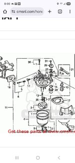

I have a GENUINE Honda GX200 with a GENUINE Keihin carburetor that I need to do a thorough cleaning on. I have B&S 19061 and 19062 hollow ground "jet" screwdrivers.
Neither one will engage the slot main in the main jet !
What do you use to remove the main jet ?

Snap-on has two screwdrivers that are perfect for that. Between the two of them they will work on all carburetors.

I just took apart my son's Keihin FCR have it soaking in Berrymans carb cleaner. Jets came out with Snap on SSDE64B no problem. It's the larger one of the two pictured below.

Find a hollow ground bit that is .031" thick by .187" wide.
If you can find one that's longer than the standard 1 inch length, that would be even better.
The reason I say that is because the 1 inch bit barely reaches the jet before the bit holder touches the carb body.

I solved this problem using a a slightly too thick slotted hollow ground bit which I got to fit perfectly for Quadrajet jets using a belt file. The belt file wheel fitted the factory hollow grind perfectly and with minimal grinding I had the perfect fit for the jets.

They can be difficult because of the odd size. You can grind a too wide blade down a bit, the blade thickness if the most critical aspect. If the jet is super tight/corroded, try tightening first before the soft ears start breaking off trying to loosen. Be sure to take the fuel screw out as well. Use heat to soften the "glue" that holds that limiter cap on. If you just pry on it you will break the screw off, then the REAL fun starts. See the "waist" in the pic. It is below the recessed area of carb and is hard to get a L/H drill bit on. I work on these all the time over the last 10 years.

Are you referring to the minimum speed screw which holds the primary/idle jet in place ?
It was perfectly clean.
In the pic 5/6 is the fuel screw (6 comes w/ limiter cap), 12 is the plastic idle screw that holds 36 plastic pilot jet.
If the float bowl was clean and you cant get main out you could try just blowing some carb cleaner through the jet and into carb throat. If problem is poor idle, problem is likely in the pilot jet circuit (that plastic jet and fuel screw)
That is the first time I have seen a Honda/Keihin, or any relatively modern clone, with a FUEL SCREW !
The primary/low speed jet (#36) obviously controls the primary fuel flow. The main/secondary jet (#35?) controls off idle fuel. NO ADJUSTMENTS !

My son's Keihin has a fuel screw (red below).
