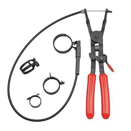

Changed a radiator hose for a buddy of mine this past week, and ran into these damn things again:
http://www.kythri.net/tools/*****-clamps_2.jpg
Ended up muscling them out with a pair of hose pliers, but there has GOT to be a better way.
Is something like this:
http://www.amazon.com/dp/B000I1G0XM/?tag=atomicindus08-20
that better way?
That's the Astro Pneumatic 9406 hose clamp plier set. I'd imagine one or two of them should be able to make short work of these various style clamps.
Other recommendations?

My OTC order back in January got cancelled (Amazon reseller) so I bought the Astro Pneumatic set of 7 (model 9406) and have to say, they're absolutely amazing.
The cable pliers have performed phenomenally, and the other stuff in the set is coming in handy on the other projects I have.

I wouldn't bother with that huge expensive set. The cable style tool and a standard plier style should do fine.
I've done great with a craftsman cable style plier and one of these with the grips though
http://store.harryepstein.com/cp/WildeChrome/260.html
Can't see from the picture but it's basically just a slip joint plier with special grooves in it that are made to work for hose clamps.
Bought my cable ones after spending 30+ minutes trying to remove the clamp on my brothers contour's upper rad hose with regular pliers which looks a lot like the pictures you posted.
Might have to invest, I just use duck billed Channellock pliers or even normal slip joints, the only issue is if it's on the opposite side from you, and you can't get at it from above/below the vehicle.

I've got two problems there - first is, on the radiator hoses I just did on my '99 Explorer (two upper, one lower - 6 clamps total), I might have had the clearance to get to two of them like that.
Other problem is, and maybe I should play with my Knipex a bit more, but when I've tried to use pliers in the past like that, clamps would twist off and go flying.
The cable pliers in my Astro kit ratchet down and lock, so I can free my hands to adjust/remove/attach the clamps and hose.

I have just the cable tool and it works well on the harder to reach hoses. I couldn't imagine trying to undo a some lower radiator hoses with a pair of pliers. There just isn't any room and a few times the clamp was rotated so poorly, it was hard to get off even with the special tool. My guess is they were put on prior to installing the radiator.
Yep. Spent 2 hours this weekend f*cking with the lower radiator hose on my 99 Yukon OBS 4x4. Hands are pretty mangled up. Got done with slip joint and Knipex Cobra pliers, but wasn't easy; just no room to maneuver on either clamp. Ordered some cable hose clamp pliers from Sears.

I have been researching cable tools and just ordered a set for myself, the NOS KD Tools 3836 from Amazon for only $99, haven't received them yet. Can't wait!
I use these exact same ones myself. The cable type make them SO easy to use. Just have to watch out for cable stretch after a while, and if it's a tight fitting clamp on a swollen hose, you may not get enough pull from the clamp to successfully get the clamp itself out of the way.
A correct observation, but as an old Bicyclist I am baffled by those who just give up on the tool at this point (not saying Fastbird did, but others have). Simply put some kind of bushing between the cable and and the back jaw of the plier! The proper fix is a Cable Sleeve, any aircraft cable or bike shop should have plenty, but in a pinch you can just drop a Roll Pin in there to take up the slack.
The other tactic is just order an adjustable tool like the Astro Pneumatic, but if the adjustment runs out, it's still not done yet.

If the access to the clamps is poor the cable type is well worth the $40 or so they cost, recently changed the radiator hoses on my GF's Focus and the worst of the clamps would have required SERIOUS disassembly to get to with pliers and the tool was a big help even on the easier ones. Sears/Craftsman carries a decent one and it is made in France FWIW...
Before I had the tool I resorted to compressing the clamp in my vice and then holding it that way with a zip tie, that did make installation easier...I cut the zip tie once the clamp was in place.

Honda seems to use clamps like this that have a detent/notch that allows you to open them fully and they will lock themselves open (I stumbled on this feature by accident when replacing the hoses and coolant in our Acura). I think that type is shown in the pic above for the cable pliers, the center clamp in the set of 3
One could probably order the equivalent Honda clamp size for whatever vehicle you are working on to have better clamps for next time....no wire ties required :)
