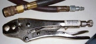

If anyone is just doing airlines, I got a crimper from PAL for about $10 that does the job, pictured below. HF probably has them too.
When I was making up hydraulic lines, I used a two piece reuseable screw on fitting that did the job. Could have been the ones mentioned above.
