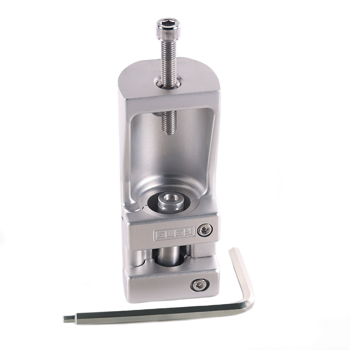

This looks interesting. Has anyone tried them> Eley
I have the Eley tool for making short sections. Eley used to sell custom lengths, but now sells this tool and the hose fittings so you can make your own. This one is to fill my dog water bowl.
