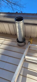

dave*99
May 5, 2009
4,302
Coastal NJ
My contribution
In the attic, on the other side of the same wall, before insulation:

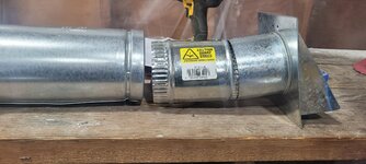

Does anybody know what kind of adapter is needed to go from the B vent to the Modine terminal cap? Also, Anybody know what is the best way or product to seal between the vinyl and the pipe? Thanks.

I spoke with Hart and Cooley, the company that makes the B vent that supplyhouse.com sells, and they told me what I can use, which is just a piece of single wall adapter from home depot.

I spoke with Hart and Cooley, the company that makes the B vent that supplyhouse.com sells, and they told me what I can use, which is just a piece of single wall adapter from home depot. The more I think about it, I may just buy a crimping tool and crimp the modine end cap so that it fits better into the B-vent and just skip the adapter.
