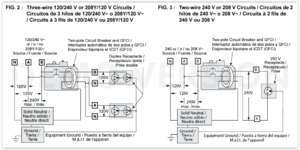

from Siemens
The Siemens 2-pole GFCI circuit breaker can be installed on a 120/240V AC single phase, 3 wire
system, the 120/240V AC portion of a 240/120 volt, 3 phase, 4 wire system, or on a 208Y/120 volt, 3
phase, 4 wire system. When installed on these systems, protection is provided for 2 wire, 240V AC or
208V AC circuits; 3 wire, 120/240V AC circuits"

Let's clarify this.....the circuit protected by the gfci cb does not a neutral as part of the circuit being protected.
The gfci cb however, needs to be connected to a neutral for the internals of the cb to function.

Which mode of tripping are you referring to? I believe for ground faults it is 100% required as the circuity and logic processor need power. Possibly for overload/short circuit it may function as a standard cb w/o panel neutral connected to cb. Can't say I ever thought about not connecting it.....otherwise, what is the point to buy/install it?

For academic purposes.... Take a 2 pole GFCI breaker and completely omit connecting a neutral. Take any or both phase conductors and leak its rated current to earth (typically 6ma) It will (in my experience) trip. The internal potential relay and its CT dont rely on logic (at least not where I've seen). The logic is for automated periodic testing and sometimes feedback. Could you imagin a potential death riding on the hope that a little logic board is working properly? Admittedly Its been many years but at one time we were required to test every breaker installed for a particular large commercial customer. Sometimes I think it would be neat to make another test rig if only to show green horns trip curves and show how potential Short circuit capacity can have affect

Even if the hot tub doesn't need the neutral, you'll need it to make the GFI work. It won't trip without a neutral.
I should have been more clear......I meant the white wire needs to be connected to the neutral bus in order for the GFI portion of the breaker to trip. The overload and short circuit portions will work without the white wire connected.

Every GFI breaker needs to have the built-in white wire connected to the neutral bus.
Not every GFI breaker will have the neutral connected to the load.
The built-in white wire needs to be connected to the neutral bus because the internal GFI circuitry is 120 volts and uses one of the poles and the white to operate.
