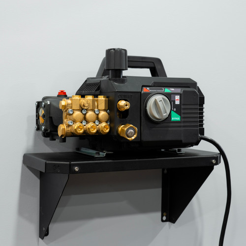

I think I’m going to pull the trigger on the following…
PCustoms
Jul 23, 2011
23,085
VT
Probably the last place I'd buy a pressure washer from.
