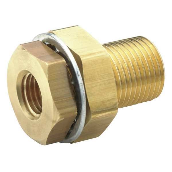

This might be a stupid question, but I'm gonna ask anyway. I don't have a garage, so everything I do is in my driveway. What I'd like to do is run an air hose from the compressor in my basement, under a crawlspace and have an air outlet on the outside wall by my driveway so I dont have to drag a 100' hose around the house..
So my question is, how can (or how do I) mount an air outlet so I can plug a small hose into on the exterior wall by my driveway without it looking like this big stupid thing on the side of my house. I can drill a hole through the wall to run the hose, but I can't find any type of bracket that I can use that will hold the quick coupler right in front of the hose inline with the hole behind it. ( so the bracket and coupler covers the hole in the wall and air hose behind it )
Suggestions, pics and part number much appreciated..

Depending on the thickness of your wall, you could use an anchor coupling.
Available at Zoro http://www.zoro.com/i/G4595507/?category=5764

Just drill a hole through the wall and stick a stub with a coupling through it. All you will see is the coupling. You can use pipe straps on the inside of the wall to secure it.

This is something like I was thinking, so it just looks like an outlet... Does the thread of the air fittings also fit black/ galvanized / copper pipe? Honestly never thought of that.. Would def make it easy..
