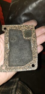

Couple of questions here about this torpedo heater I have been using for years. When I bought it it had a clogged nozzle and broken ignitor. I fixed those, and it has worked like new for 7 or 8 years now. I have never had to do anything to it, it fires up every year for me.
This year I pulled an old oil tank out of my basement. Since this thing says right on the top it burns heating oil #1 and #2 I filled it with that oil which was not too dirty, because it was the first cans I filled out of the tank before I got to sludge. It was clear and red. It tried to fire, but it smoked, then went out, and gave me ****. I opened the rear and attempted to tune the air/fuel ratio, but had no joy. So since I then assumed it was too dirty to burn in my shop even if I got it going, I gave it all away to a guy with a diesel VW who runs cooking oil and stuff.
Problem now is I put fresh kerosene in it, and I get zero ignition. I do not know how this fuel pump works, and I messed with the dials without first noting how many turns out they were. I probably should have taken note of that like working on a carb. So I m not sure how to dial it back in because I was not thinking.
Other problem I have is also fuel related. I put kerosene in, and I am not getting any fuel to the nozzle. I removed the nozzle thinking it may be clogged, and stuck the end of the fuel line into a bottle and started it up, I didnt get a drop of fuel. I turned the fuel pump thing so see if that gave me fuel and tried again, but get nothing. So I am not sure if I turned a dial on this pump the wrong way, or if sediment clogged a line in the tank. I am not sure how to clear the line on this so I get fuel again, then dial it in. The lines are glued on, not clamped, so I would really like to NOT have to cut them off and create another thing to fix.
For dialing it in, I figured I would use my O2 meters, look at how much smoke I get, and the smell. Any pointers on this stuff would be appreciated.
I dont hire people to fix things. I know this is fuel related and can kill me. I am good and follow safety procedures and stuff, I also have a giant exhaust fan for running engines in my shop roof. I just would like to get ignition at this point. Right now I am kind of flying blind on why I have no fuel.
I also have a large compressor and can blow air through if that's in any way a good idea. I didn't want to try and find out its a bad idea.
Any help you guys can offer will be much appreciated. Thank you in advance. I am going back out to my shop now, and will look at this thread again in an hour or so, then I will try your suggestions and let you know if it fixed my problem so it may help the next guy too.
