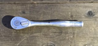

I'm looking for a vintage Cornwell ratchet. I understand how to service the ratchet gear heads that have snap rings, but some ratchets don't seem to have snap rings around the gear head. I found a representative photo of some 1/4", 3/8", and 1/2" ratchets I've seen on Ebay that don't seem to have snap rings.
I searched YouTube and this part of the forum, but couldn't find an answer, so I need your help.
How do I disassemble the gear head on these?
Thanks

The right way: Use an adjustable pin spanner to remove that cover plate.
The wrong way : Use needle nose pliers.
(The cover is threaded and there are holes for a spanner.)

Thanks.
Newbie situation here: I can't find an "adjustable pin spanner" at my usual stores' websites. Can you give me alternative names and/or leads to big stores that have it?
Also, I have snap ring pliers on hand; would those work?

Snap ring pliers may work but those plates are often really tight.
I've also just took a piece of 1/8" x 1/2" steel bar or piece of scrap metal, measured the C-C distance for the holes, and drilled holes in the bar that far apart. Drop two drill bits into the holes shank first, and put them into the holes in the ratchet, and you have a makeshift wrench to remove the plate.
I like your idea better than my hack method . :beer:

On my Superratchet, I did the same. Used a pin punch and lightly tapped until it turned.

I'm glad Cornwell went away from this design. The clips are so much easier to remove. i know the threaded faceplates are in theory better, but it's overkill imo. This is personal preference.
The only downside of the clips is they are spring steel and harder than the ratchet, so they can wear the ratchet over time if there is enough slop. If this happens the ratchet can disengage under load (not common but I've noticed it in other brands).
Cornwell solved that by making the steel ring the clip rides in a separate piece from the drive stud.

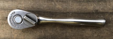

My wife spotted this 3/8” drive one at a local estate sale. Since it works just fine, I probably won’t be taking it apart. I have a smaller 3/8” drive one with the snap ring that I bought long ago off of the Cornwell truck. It’s my go to stubby ratchet.
What a great find!

I would expect to pay $5.00 or less for a ratchet at an estate or garage sale and about the same at the flea. My ratchets do not have a port but all of my 1/4” drive Waldens of the style below have the port and I’ve only seen a couple with plugs in place. I see no problem whatsoever with leaving the ports unsealed. They make it very convenient to spray cleaner in the mechanism followed by 3 in 1 oil or Superlube.
