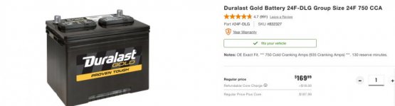

The battery in my truck is going bad and needs replaced. I am looking for a good replacement battery, and a sale/deal if there are any. There are so many different types of batteries with the "CCA", "Group Size" and the "24F" numbers on them, I have no clue what those mean:headscrat:dunno:??
What is a good type of battery for me? I park my truck outside all year long here in Ohio. Thanks!:bowdown::beer:
Are any of these good batteries and deals?:willy_nil

The Group number dictates the physical size of the Battery. (more or less)
Look in your Truck to see what Group number is in it.
This is what will fit in the Battery space and cable connections being correct.
Then look at the CCA to see what OEM installed. (it maybe a low number)
Decide on how well it has been starting for you and may you need a little more power to start it as the Truck ages?
Ex: Changed the Battery in the wife's Subaru recently, OEM was 360cca. I upgraded to a 600cca with a 60 month replacement Warranty. Thought process is that it always started in Sub-Zero weather with the smaller Battery BUT what if she gets stranded? How far would I have to drive to Bail her out?
I figured the Warranty is a good time period to weed out Manufacturing quality issues.

So does this look like a good battery? I filled out the information for it to match batteries for my vechicle.
FREE INSTALLATION & TESTING; OE Exact Fit; OE Spec: OE Group 24F; OE CCA 585; Battery Spec: 750 CCA; 935 CA; 130 Minute Reserve Capacity; 3 Year Free Replacement
This one is $204 out the door.
