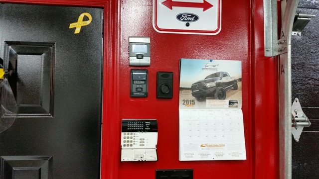

Actually the wired button is the easiest to hide since I have no ceiling up yet I just ran the wire behind the opener and you only see about 3" between it and where the tin will be.
Yes, the wires for the IR, cable tension and the dead bolt are the one I'm most concerned with as they run the length of the door and just look "untidy" (I know its a first world problem but if your going to do something just as well do it right). Ill get some pics this evening.

I hit most of my wiring too. I can post pics tomorrow if anyone wants to see. I too wanted the wiring as hidden as possible. My interior is done with hardi-panel so I can just spackle over or the texture would be gone. (It looks kind of like T1-11)
