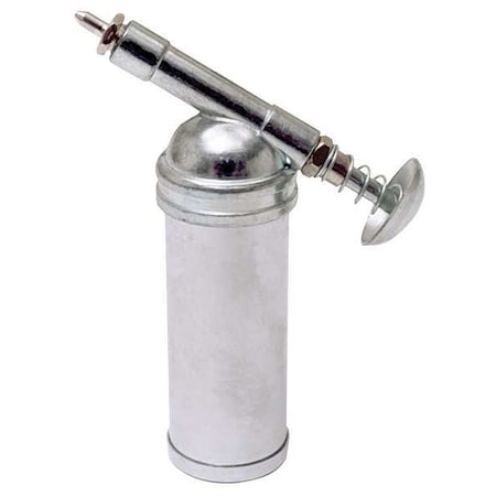

I oil my air tool before each use for the day( put 4-5 drops into bottom of tool through air fitting) and try to when I store them. But I have some die grinders that have a small oil/ grease port by the head of the tool. It says to grease.
What do you use to grease these tools?

http://www.zorocanada.com/i/G744994...hxgV28HwJPpKSfFUFOIJ6xoCQYvw_wcB&gclsrc=aw.ds

I use the lithium grease on my air tools so far no problems. I try to get the straw from a wd40 spray can and insert it into the spray lithium grease can. To inject it into the hole. Sometimes you can get the straw lithium with the straw with it.

I had a Tekton inline oiler but I think it's restricting air so I removed it and just put 4-5 drops in the air inlet at the start, every 4 hours of use and end of use. If there's a grease fitting I'll inject some IR air tool grease.

I put Marvel Mystery Oil in the air fitting and grease the head if there is a grease fitting with a plastic push type grease gun that you would use on your chain saw bar.

I oil mine with air tool oil before using them and if doing lots of work during the work. I have found that greasing the zerk in the back of my IR impact guns just blows grease all over the customers wheels.

Does anyone know of a substitute grease for IR impacts? Packed mine with regular Moly grease, and its awfully sluggish in cold weather.

I just use an EP-0 grease in one of those mini grease guns like pictured above. I have it on hand for the gear boxes on my string trimmers and it's called for on chain saw bar nose sprockets as well as other OPE uses.
Most grease that you can easily get is NLGI-2. As several people mentioned use a grease that is rated NLGI 0 or 1.
