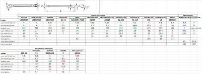

If you look carefully at the chart below, I compared popular US and (long) Euro wrenches to their relevant standards. Color coding is a little cryptic. I was trying to suggest green was best in a category, red was worst.
If you read between the lines, you will see the trend I see. Snap On makes really long thin strong stuff which is pretty awesome. Note that Snap On normal length is longer than the long pattern in the DIN3113 (last column). Snap On long pattern is super long.
I made this chart many years ago. SK SuperKrome was the pre-Ideal SK.

I wish Wright was the same length as Snap-on standard length.
We rave about the strength of WrightGrip open ends, but truth be told some of that strength comes from thickness. Thickest in the pack.
