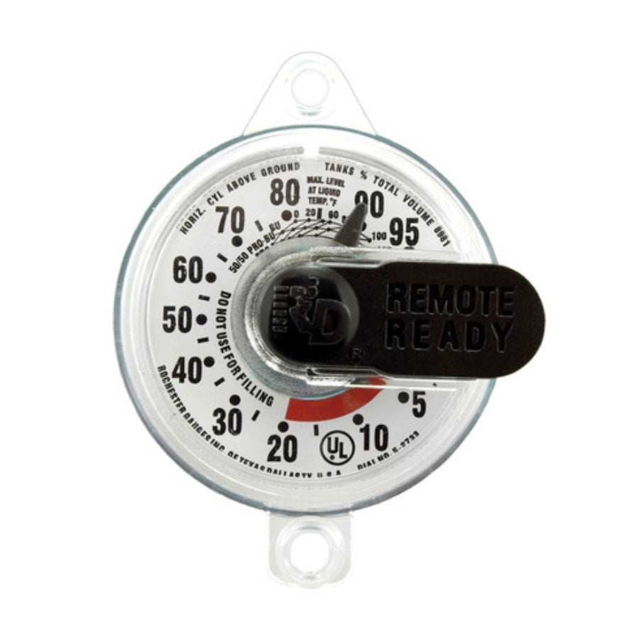

This is my neighbor's tank, they are older, so I watch over them, especially during bad weather like the cold weather we're having right now. I checked their tank gauge, but I can't find the indicator.
What do you think it reads?

A bit of info above If the screw comes out easily then remove it or rotate it and see if the pointer appears. Call the fill company and ask them for advise.

First picture sorta looks like 20%.

Here is gauge that was in my pocket. You can see what the pointer looks like.
It’s a 120 gallon tank gauge so the printed face is slightly different than a 250 gallon plus gauge.

What does "remote ready" mean? Is someone supposed to be monitoring this tank remotely?
You can put a monitor on that gauge, that talks to the cell network and keeps your company informed of the level at all times. Neevo is the most common brand but westroc makes them as do others I am sure. They even connect to an app on your smartphone so you can check the level without going out side

Have you pulled the rubber plug? Needle might be underneath. I go into my local lp company office pay cash or local check and get a discount. Minimum is 150 gallons delivered.

The red bar isn't an indicator. There should be a pointer
And I remember seeing the black pointer the last time I checked the tank for them a couple months ago. The thing is, I don't remember the "Remote Ready" black thingie on it.

Its empty. If you slide the black tab off for the monitor you will see the pointer underneath it.

I went and looked at it again yesterday around noon, this time I brought my reading glasses.
You were exactly right. If you look from the "below 50%" side, you can just see the pointer. it was a hair under 5%.

Sub 5%. Look close and you can see a shadow above the 5. Either way get it filled asap so it doesn’t run empty.
Have them call in and ask to be put on keep full or ask for the remote monitor to be installed. I have them on all 8 of my various tanks. They’re great.
That looks like it. Try to look at an angle under the black tab.
