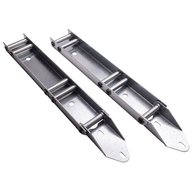

Hey all,
Will be replacing old existing wooden garage door sometime soon.
At the moment with standard track , the overhead clearance at the top of the arc is like 2 inches. Here are some photos of the measurements I have.
I don't really want to do a wall mount.
Are there any track systems on the market that can possibly increase my clearance enough? Haven't been able to find any on my own that state they address such tight overhead.
Thanks!

There are special upper hinge devices that lay the door back much faster upon initial opening, changing the arc of the door top. I had to use a pair of them on my door to be able to use a fluorescent light fixture in that area. I got them from a local overhead door company for $20 at the time.
My door was striking the lower chord of a truss, and this device allowed about 2-1/2” in that area if I remember correctly. If I got out there today I will try to get a pic for you. I could not even install a ceiling before that.

What do the tracks near the upper corner look like? Might be able to use some low clearance tracks to gain some clearance for the opener. I'm thinking of double tracks something like this.
https://www.menards.com/main/hardwa...m-kit/low-headroom/p-1444433956510-c-7577.htm
You could just whack a notch in the ceiling supports for the opener track. Would not recommend this approach that previous owner had done in a place we rented out. Ceiling was sagging. It was joists not trusses. I put additional joists higher and cut out the sagging ones and was able to make it work.
Oh, cool. Thanks for this. All I was seeing was that Sneaky brand which are like 75 bucks.
