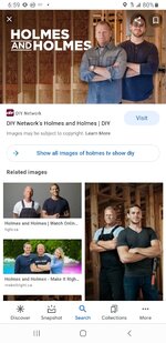

Holmes show used it since they been on TV
And blue wood. Never saw that anywhere else.
Sent from my SM-N960U using Tapatalk
