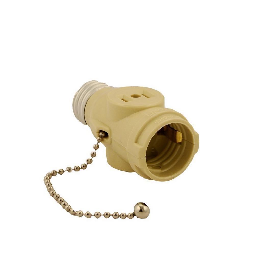

And end result will probably look something like this
I was thinking of something more along the lines of
https://www.kyleswitchplates.com/round-duplex-outlet-cover-wall-plates-white/
Mount a duplex outlet into the box, put a round faceplate on it. The ceiling is finished and painted drywall painted white, but I don't have a good idea how to make the cabling look nice. I don't really want to cut up drywall. Maybe there's some kind of conduit that can mount to the ceiling between LED strips that don't look to bad to hide the cabling.
I noticed that none of my current garage outlets are GFCI, house was build around 2011. CB as far as I can tell is not GFCI either. However, If I turn off the garage CB, one of the GFCI outlets in the basement green light goes out. Seems a bit odd.
I don't want to use an incandescent adapter like that, it looks hideous. I have a little bit more pride than that, but not much.
Yup.
All the 4 foot shop lights in my fathers basement were plugged into those types of adapters whenever he added/wanted more light than just the regular screw-in 60 watt bulb would give. He had a total of eight 4 foot fluorescent shop lights plugged into 4 of those adapters. And they were all powered off of one 20 amp circuit with one light switch.
When we had to sell his house last year after he died, those things were still powering all the shop lights after more than 30 years. His house was built in 1954, with the electrical service being upgraded to 200 amps back in 1987.
Do I use them? No. Did he use them? Yes. Did they work? Yes. Was there ever a problem with them? No. Did we have to remove them for the sale of the house? No. Did the buyers inspector say they violated any codes? No.
I don't know if these types of adapters are against any current NEC codes when it comes to non-permanent lighting using cords with plugs on the end, versus hard wired permanent light fixtures, but if someone out there knows more about it, please let us know.

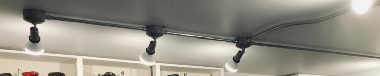

I have a basement room with shelves to display my collection of bench vises. I used EMT conduit over the drywall ceiling to run electricity to my light fixtures.
Here’s how it looks.
I started with a single light fixture mounted over an octagon box in the middle of the ceiling. I attached a new cast aluminum box over that recessed box and ran EMT from there. Lots of options for easy future expansion. Totally reversible too. If I had to, the entire installation could be removed and one ceiling light could go back in. Just a few screw holes to fill, repaint the ceiling and it would be back to a conventional room.
You could paint the conduit if you wanted to. To me, it looks better just clean and new looking.
MerlinsBeard
Mar 27, 2020
398
MD
Thanks for the pic, looks better than I thought it would. And your hobby matches your profile pic too, nice!
