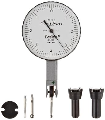

For run-out, I find a test indicator more accurate:
