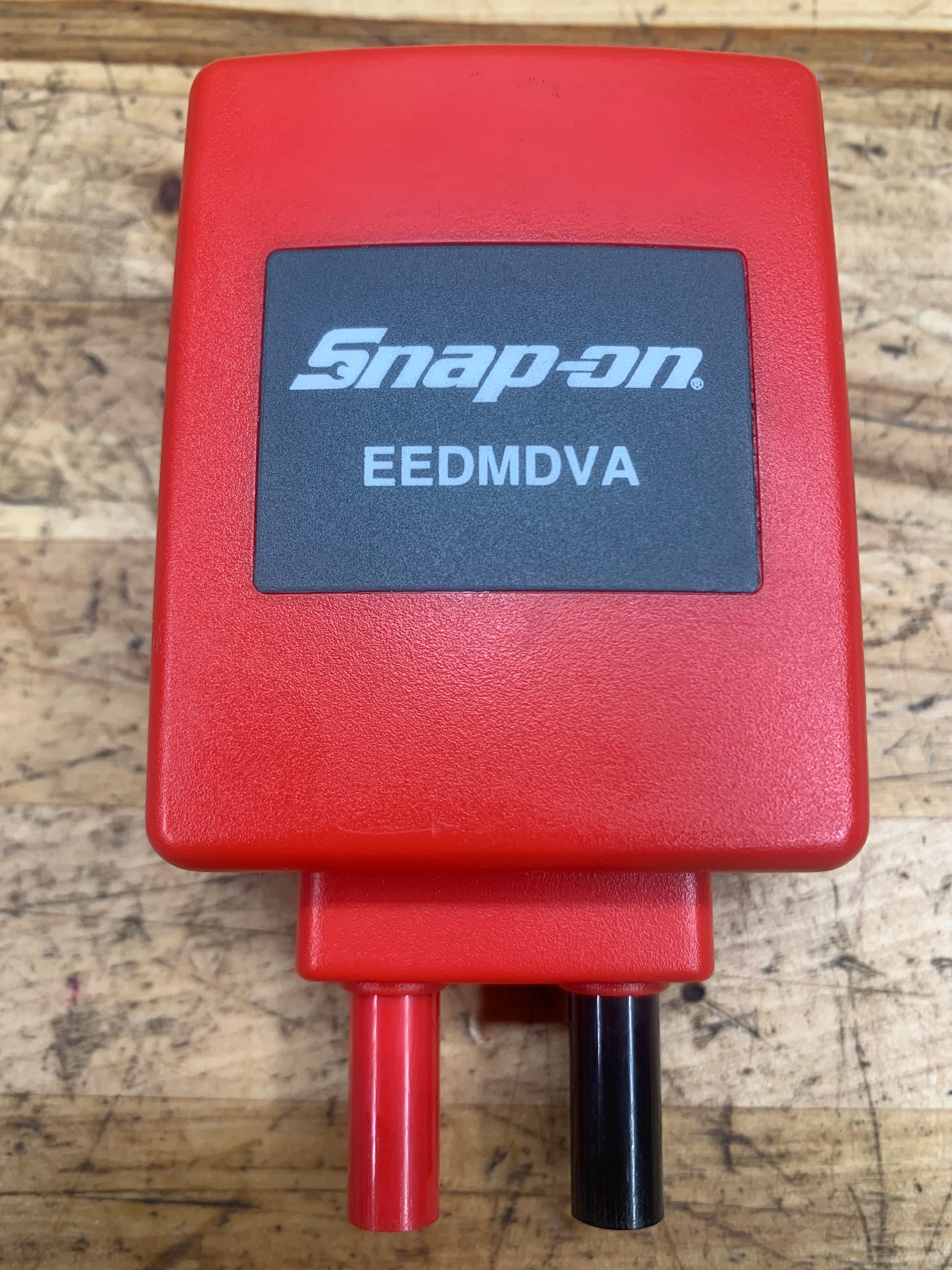

Snap On Direct Voltage Adapter EEDMDVA​
For sale is a Snap On direct Voltage adapter. This tool converts outboard marine, motorcycle, and other small engine ignition pulse signals into DC voltage signals. This adapter connects to a multimeter, and helps identify secondary high voltage ignition problems like a failed coil pack, or poor spark.
