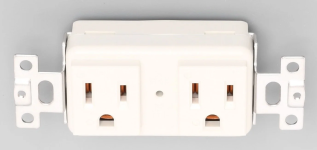

That is hideous. I say that as the target audience for these. I live in Chicago, and most of the outlets in my house are horizontal. Including the ones we’ve added, because it would be weird not to match. Outlets in multi gang boxes are vertical, we’re not heathens.
