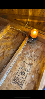

I have a 220V air compressor that lives in a compressor shed hooked to my detached garage. It is on a dedicated circuit with a toggle light switch to turn it on and off. The problem is that I sometimes forget to turn the switch off when I leave - it's on the opposite side of the garage from the door. Since I don't go in there every day, the compressor will sometimes be powered for days and kick on and off to keep the tank fully charged.
Is there a way to hook some sort of light to the switch that will stay on as long as the switch is on? A light would get my attention when I turn off the bay lights to leave.
In my house are several 110V switches that glow when turned on. Is something like that available for 220? I'd rather not call an electrician unless necessary, but will if that's the best option.

You can buy 240vac LEDs from Jeff's jungle site (attribution to @kaymccampbell ) that you can hook to the load side of the switch. This will light the LED as long as the switch is on.
I did this by mounting my 240vac motor load rated switch in a 2 gang box, and modifying the 2 gang cover (one side opening for a switch and the other blank) to have a hole for the LED.
The job wasn't hard, but as to whether you can DIY, it sort of is like the old saying, if you need to ask the price, you probably can't afford it.

should be easy to obtain a 240v pilot light , or wiring in 2 @ 120v in series will work . you can use the existing switch
Two in series definitely works. Need to be identical though. For 240v you can probably find the right bulb.
I did that one with (2) 240v ice cube relays. Needed 480v but they don't make that coil voltage.

Or big sign(s) at exit door(s) "Turn Off Compressor" Save your $$ for something else.:)
These days the sign is more than the LED.
I put a small LED on each 220 outlet in my shop.
I can quickly see if the welder, saw. or lift outlets are on.
Also, a good way to know if you pop a breaker.

Just to be clear a 240 volt light would be a code violation in a residence. I am not saying never break a rule but one should be aware that they have made a choice if they do.
I would find an old phone charger in my junk box. Most are rated to operate on 240VAC and connect it to the compressor so it gets power when you want and connect the low voltage wires to a LED where you want it. Note you will generally need a resister in the circuit.
