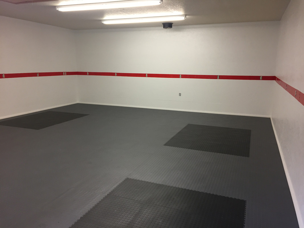

Assuming the walls are primed and ready for paint, figure out where you want the red stripe. Also how wide that stripe will be.
Paint that red, doesn't have to be perfect, just make sure you paint WIDER than the finished red stripe will be.
Now once it has cured, mask off the stripe, covering the red paint. Mask it to the width you want the stripe to end up. No use that masking to paint the white above and the grey below.
Peel the tape and you should have sharp edges on the red stripe, with the white and grey on either side.
Plan the strip for a common width of tape to make it easy on yourself.

You could prepaint some thin trim, maybe 1/4" pine and mount it with trim screws or brads.
If you don't want to do this yourself, you should get at least one more quote. The guy that gave you that price might not want or need the work.

The best way I have found in painting stripes is once you have masked off the area where you want the stripe, you need to seal the tape to the wall with paint so that the new color can not bleed through under the tape
So if your working on the red to white transition, go over the edge of the tape
with red paint, let it dry and then paint your white. When you pull the tape you will have an extremely sharp line

I agree that sealing the tape down with the paint of the color that's going underneath it will stop bleed through, but it also presents two problems.
1) You now need more white to hide the red. Not a big problem, but just something to keep in mind, and
2) Putting tape over fresh paint is a BAD idea, as all too often the tape lifts with the paint under it. Yes, they make green and purple tapes for this purpose, but I've had them all lift chunks on different occasions.

Too many recommendations for painting the red first. That's creating a lot of extra work, as red is the "hottest" color you could possibly paint. It will bleed through everything but black, and sometimes even then you will see through it.
Paint the white first, then the grey, then mask of the red stripe for last over the top.
The trick with painting stripes with perfect edges is that once you have masked off the stripe, you "seal" the edge of the tape with the original color underneath it (in this case, white or grey). That seals the edge with a color that if it leaks, you won't see it. Then paint over the top with your stripe color. It works beautifully, without having to run a bunch of coats over a dark color to get complete coverage.
Work light to dark and you won't have any coverage issues.
