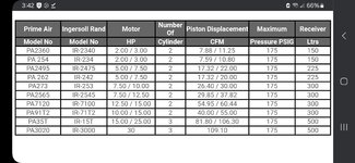

Lot of info there and I'm sure you will get some suggestions ranging from using the pump you have, to replacing it. You may be able to rebuild it, but I highly doubt there is any way to "upgrade it" to get more flow. The flow is a function of the displacement and the rpm. Changing the displacement is not worth it, and running it over the spec rpm is not a good idea either. All that said, let's make sure there's even a need for an upgrade.
You keep talking about how much pressure (psi) you need, or would run the pump at, but you can't change the pressure of the pump (without significantly modifying/replacing the pump internals). It will simply build whatever pressure the discharge end of the second stage cylinder/valve is designed to build (which appears to be 175 psi) Even if you speed the pump up, it won't build more pressure, it will just discharge more air (cfm) at that max pressure.
What it sounds like you're really interested in is flow. Yes, speeding the pump up will increase flow. It will also increase heat, noise, and wear on the pump. It looks like the 234 was designed for either a 2 or 3 HP motor which allows it to make 7.8 and 10.6 cfm respectively (though we aren't told at what pressure).
Only you can decide if that's enough flow for your use cases. But remember the amount of air you can flow instantaneously is not dependent on the pumps throughput. If you charge your tank up to 175 PSI, and then start to flow air from the tank, depending on what restrictions you have downstream in your distribution system, you will be able to flow anywhere from dozens to hundreds of CFM. It's only once your tank drops below the cut in pressure that your pump becomes the limiting factor. If you run a 250 gallon tank, that's a lot of air you can use before your compressor even kicks on. That said, for something like a DA sander, when your compressor kicks on, it's going to run constantly and will not be able to keep up.

Thank you for the reply. Its sad the way they (manufacturers/advertisers in general) rate things, you can just assume that, according to the chart you shared, at 2hp it would be 7.59cfm at the specified 175 psi, and 10.80 cfm at 175psi using 3hp. I mean, its completely plausible that is what they mean, especially considering things weren't quite so misleading when this pump was likely manufactured. However its definitely not worth assuming.
What I mean about not running the pump at 175psi may be worded misleading, however what I mean is I am likely going to set my cutoff switch at 120-150psi, meaning the pump will not be forced to bring my tank pressure up to 175 psi. However the more thought I put into it, the more I realize that if I do let it fill the tank to 175psi and regulate my output from the tank to 120, it will give the pump a little extra breathing room which seems.like it would benefit from long term
I am guessing the reason I haven't been able to find solid cfm figures for this pump is because they don't officially exist. Interestingly.they can be roughly calculated by draining your tank, and timing the fill time, however if you want dead on numbers you have to account for atmospheric pressure and the volume of air in any attached lines including the plumbing between the pump and tank.

The IR-234 has a smaller displacement than the more modern version. Spinning the pump faster than it's intended will generate more air, but it's going to do it inefficiently. It's going to make a lot of heat, and likely have reduced lifespan. I doubt the compressor is going to throw a rod or anything like that, but you would be better served by getting an actual 5HP rated pump and spinning it at its rated speed. I can't comment on the HF pump, other than that its CFM rating seems a bit low - probably not a terribly efficient pump.

The 234 was designed for 2 or 3HP operation. It turns at ~1000 RPM with a 3HP motor. IR used a 5HP motor and spun it up to ~1500 RPM so they could have a cheap 5HP machine to sell at Home Depot and Northern Tools. Call your local IR distributor and have them send you the engineering data pages so you can sort out the correct pulley and motor size.
Find an IR distributor
Turning a reciprocating compressor at a higher speed will lead to higher maintenance and a shorter life. That's just the facts.
