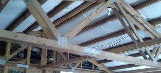

I have a pole building with metal siding, wood framing. The ceiling/roof currently has 2" vinyl backed fiberglass blanket insulation. I want to increase the insulation value of the roof without putting in an actual ceiling if possible. I don't think my trusses are engineered for a ceiling. and they are spaced way far apart. There is NO eve vents or any vents. If I need to vent I would lean more towards gable vents as I have no eve overhang to work with so would have to re roof all together. The goal here is to do this correctly with as little cost as possible and still keeping it simple.
The insulation blanket that is in place right now is in good condition.
I have talked with insulation companies and have gotten very conflicting information.
1. One place told me to just add in F-Glass rolls between purlins (no air gaps) then put another vapor barrier on the purlins and call it good. (My concern here is there is a double vapor barrier...maybe this is ok )
2. I was also told to slit the current blanket then add in the F-Glass insulation then put in a new vapor barrier. (my concern here is if moisture gets in the insulation the purlins will be in the we insulation ... maybe causing rot?)
3. I have also been told to just use spay foam directly on the current insulation blanket. (Not sure if the spay foam would damage the insulation blanket, and would be $$$ but might work with no ventilation)
I really do not want to put a flat ceiling in as it would be a very very short ceiling and I would loose a good amount of light as you can see where the bottom of the truss is in this photo. I am also not sure with all the construction and lumber I would need if it would save that much money over spray foam in the worst case scenario, More information would be needed on that. Spray foam for 2" would be ~1,200 and ~1,800 for 3"
If idea number 1 would work that would be cheapest and easiest....
I also have no had wiring done so I was thinking I would run conduit on the ceiling to avoid having wiring coming in and out of the vapor barrier so the VB would be as perfect as possible.......
Sorry about the Blurry Photos.
This room will be used as a computer shop / workout room

Check if the spray foam needs a fire resistant covering.
If you use regular insulation, put in enough that the dew point remains well inside the insulation and not along your purlins.

i'd slit the current barrier every bay, get some "Basement blanket", cut to fit and face nail it to the perlins with cap nails.

I would leave the existing insulation just as it is, and add EPS foam directly attached to the purlins, so you have continuous insulation sheething between the trusses. Use the blanket nails with plastic washers, and seal gaps and joints with low expanding foam (so you don't have too much oozing out to trim up later.) Even 1" would do a world of good, and it's white so you'll still have good reflective value for lighting. Not terribly durable if you're going to poke it with things, but neither is the blanket.
This will leave a dead air gap between the foam and the blanket as well.

I suspect some people get confused when we're talking about vapor barriers and insulation in respect to roofs and/or attics. It's absolutely true that you don't want to have 2 intact vapor barriers in certain situations...the most common is when adding insulation to a ventilated attic. Some people have used kraft faced insulation blankets laid down over the existing insulation with a vapor retarder on the warm side (against the ceiling sheetrock). Regardless of whether the kraft face is laid down or up, you have encapsulated the existing insulation between two vapor retarders on the cold side of the structure. This leads to problems.
In YOUR case, we are already on the warm side. adding inslulation to the warm side still keeps the old insulation on A warm side...just not as warm as the "new" warm side. Also, you have to remember that your blanket insulation is terribly ineffective where it is compressed by the purlins. Trust me, if the dewpoint is going to happen anywhere in your assembly, it will be there. Just so happens it also has penetrations in the vapor retarder there also...not the greatest theory in insulation.
So, by adding rigid insulation over the purlins as I described earlier, you are moving that dewpoint away from that area, which is the biggest benefit. You also get a monolithic insulation layer which is at least theoretically easy to seal as positively as can be done. How well you do simply depends on your attention to detail. Also, for anyone that still thinks this whole theory is bad because of some incorrect idea about how vapor barriers and insulation and dewpoints work... 1-3 inches of EPS is going to be classified as a class III vapor retarder...not a "vapor barrier", which, in this case means that if there ever was a vapor pressure in this building which would drive moisture into the insulation, it would actually allow this, and the dewpoint would occur within this layer as it is completely de-coupled from the other insulation layer. The beauty of EPS is that it dries out even easier than it takes on moisture. Not that it matters because this won't happen if installed as described. I really don't see a method to add an EFFECTIVE insulation to your roof that is any more cost effective and get's you the end result you wanted.

I looked at your pics again...remember that with those double trusses, you will also want to friction fit EPS in between the truss gap so you don't have an open area there that would lose energy for you.
Also had another thought about adding additional fiberglass like you asked...
If you go with say 1" EPS attached to the purlins, I might be a little concerned that the weight of the fiberglass would make the EPS bow a little. Not a huge deal, but you might not like the looks. The unfaced fiberglass would certainly want to droop and the existing fiberglass blanket is "draped" so this would amplify the tendency I would think. If you used 2" EPS it would be strong enough to handle this.
You could also go XPS if you want to, but baby blue or baby pink vaulted ceiling is probably not what you are going for here. And it's considerably higher priced.
When it's all done, add a few ceiling fans up there to keep the warm air circulated back down to you, or you'll have a nice toasty vaulted area and cold toes.
