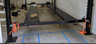

I move one last year it has the removable skates I just used ratchet straps to secure the skates to the cross members rolled it up to the trailer set up a engine hoist inside the lift on the ground picked up the front crossmember pushed it on to trailer then moved hoist to the trailer in front of the lift and lifted it over the wheel wells then moved hoist to behind lift on ground to lift on to the trailer it went real quick this way actually strapped it down good and drove 45 minutes home on the freeway the lift was just as wide as the trailer fenders only thing hanging past it was the hydraulic pump so just be careful with that when driving

Would want to either 2" angle iron or 4x4 bolted to the feet across the both ends help with racking and ratchet straps on the lengths. If the lengths had either angle or 4x4 could use pipe to roll it to move it.
