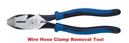

How To Remove Double Wire Hose Clamps?
peejay75
Sep 4, 2017
312
Alrighty, what is the way to expand these boogers once the screw is loosened? (Bonus points if anyone can explain how they work, as the design seems "opposite" of how I would expect them to work!)

Once the screw is loosened, there shouldn't be much if any clamping pressure. They're just wire, not spring wire (though they can be a touch springy). You shouldn't need a tool.
That said, sometimes they stick to the rubber a bit, the screw gets corroded and they can still be annoying. I often just rip them off with pliers and replace them with ear clamps (which aren't great for serviceability, but do hold exceptionally well).
They "work" because the large flat piece is threaded. When you screw the bolt in, the flat part is static and the bottom of the bolt pushes against the wire.
Alright, Jrad, you are VERY close to winning the internet...
So that tiny little washer at the bottom of the screw, it always stays in the same position, and can never move "higher or lower", thus it is what presses down on the "closed loop" and does the tightening? And to oversimplify things, these clamps just get tighter, they aren't really designed to "expand", right?

Ok, Jrad, not sure how you came across this rare piece of push-pull magick, but it works, right-tighty = hose contracts, lefty-loosey = hose expands. I would like to subscribe to your newsletter, if that is ok. :)

Ha! Yours must be in better shape that mine. Usually the bolt, threaded part and the washer all just fall out when I loosen them because, like you said, they aren't really designed to expand.
The threaded flat part the bolt screws into is sort of fixed on the wire, but the washer is just resting on top. Often when I unscrew them the wire stays in position and the bolt and washer pull themselves away from it.
I was just removing some of these from the fuel lines and filler neck on my 1976 Ford Courier the other day, so they were fresh on my mind.

Cut them off. Use whatever you have handy. Replace them with worm drive clamps of the right size.

Not yet on my Courier. I'm almost to the point where I start putting things back on, but up till now it's been exclusively taking them apart.
Engine block and cylinder head should be coming back from the machine shop next week.
I have two styles I prefer depending on whether it's something I expect to remove again or not.
Constant tension spring clamps:
Or Oetiker stepless ear clamps:
It's not like I'm too good for a worm gear clamp though. It's just not my preferred choice. It seems hard to get good ones.

The few times I've dealt with those, I tried to grab them like an ear clamp to unstick them from the rubber. Seemed to help, but the grip was tenuous.
