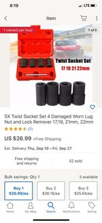

I have these....Not enough room between the nut and the wheel.
Not really have enough room for a thin wall socket
Drill the stud. It will take a long time and you will eat a lot of bits.
Start with a good solid center punch dimple so the drill does not walk. Start small, 1/4" or less. The stud metal is not hardened like the locking lug nut.
DO NOT BREAK THE DRILL BIT OFF IN THE STUD !

BTDT. if you have an autozone nearby, they sell 2 sizes of reverse thread lugnut removal sockets. thin wall, will fit deep recessed aluminum rims. they are only like $8 each. that set someone posted is too thick, the parts store ones are thinner and are more fine threaded.
