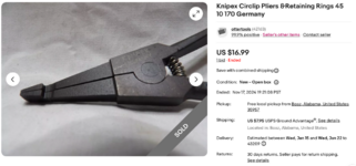

I'm taking my power steering pump apart to replace the leaky o-rings and seals. I'm stuck trying to remove this c-clip. I have an assortment of small flat head screwdrivers and picks, but I can seem to get anything under or behind it to pry it off.
Is there a special tool to spread the ends apart?

Have you tried something like this?
There are made for c clips with ears but if the tips fit in the gap, this should work. Good luck!

I had a similar clip I had to deal with on my Delta motor refurb...
This lock ring was massive (.100" thick) and required a tool that was strong enough not to flex...
My ring was so strong it left a deep furrow in the steel shaft when it was originally assembled by Delta...
Fought the battle with this Ebay pair and won...

I haven't tried any pliers yet. Thanks for the ideas. It gives me something to search for that might work.
It's a stiff little *******. I can't even get it started. As soon as I try to put any force on it, either the tool slips or the c-clip spins on the shaft.

X4 on the lock ring pliers. You'll most likely have a lot of frustration without them. You may be able to get in with a pair of snap ring pliers, but be prepared to break the tips off and have them fly away.
13,455
I think the correct tool would be a horseshoe clip pliers, see mine here

Of course there is a proper pliers type tool. There is a proper tool for everything. But if you buy the right tool for every job, your toolbox will eventually crowd you out of the shop. This is one of those once in a lifetime jobs. Two large screwdrivers pushing against each other will open the ring. A third hand from your wife can then pry it out of the groove. You only need to get it started and then work it around.
